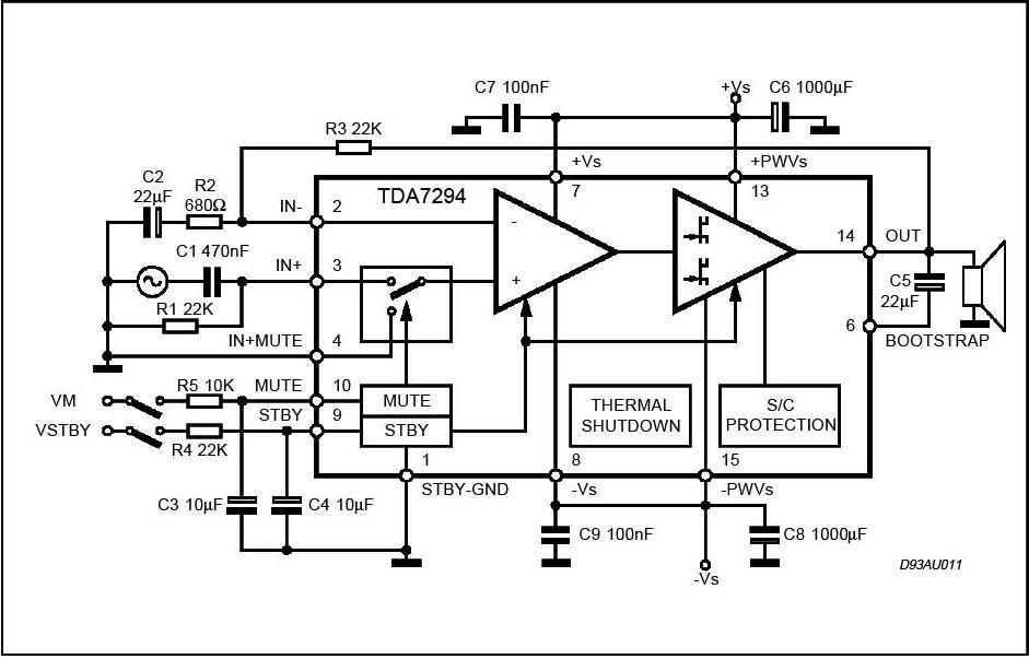

Chao ban Tranle239 mih dang dung dien thoai nen khong biet gui len day duoc neu ban thich minh co mach cong suat chay Tda7294+C5200-A1943 cong suat co 150w 1kenh mach nay mih chi co so do nguyen ly thoi nhe..hi ban phai tu ve mach nha..con ban khong muon ve mach thi mih cung suu tam duoc 1mach tren mang co so do layout+huong dan lap rap chay 2con C5200+2con A1943 cong suat co 200w voi tai 4omh..Neu ban thich ban cho minh Email minh gui chohttp://thotinhyeuhay.wap.sh
