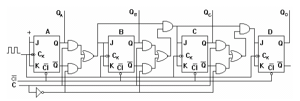

nó báo vậy đó các bác."Error: Can't synthesize current design -- Top partition does not contain any logic"
code VHDL trên modelsim chạy ko loi và mô phỏng chuẩn.tai sao dùng Quartus 2 lai lỗi

--dem dong bo 4 bit co ngo dieu khien
library ieee;
use ieee.std_logic_1164.all;
use ieee.std_logic_unsigned.all;
use ieee.numeric_std.all;
entity dem_dong_bo_4bit is
port(J,K,T,Cl,Pr,c:in std_logic;
Qa,Qb,Qc,Qd:out std_logic);
end dem_dong_bo_4bit;
architecture dem_dong_bo_4bit_behave of dem_dong_bo_4bit is
component mynot
port(x:IN STD_LOGIC;s:OUT STD_LOGIC);
end component;
component myand
port(x1:in std_logic;
x2:in std_logic;
s:out std_logic);
end component;
component myor
x2:in std_logic;
s:out std_logic);
end component;
component ff_jk
port(J,K,T,Cl,Pr:in std_logic;
Q,notQ:out std_logic);
end component;
signal nc,nQa,nQb,nQc,nQd,and1,and2,and3,and4,and5,and6,a nd7,and8,or1,or2,or3:std_logic;
signal kq1,kq2,kq3,kq4:std_logic;
begin
ffA:ff_jk port map(J=>J,K=>K,T=>T,Cl=>Cl,Pr=>Pr,notQ=>nQa,Q=>kq1) ;
a1:myand port map(x1=>kq1,x2=>c,s=>and1);
n:mynot port map(x=>c,s=>nc);
a2:myand port map(x1=>nQa,x2=>nc,s=>and2);
o1:myor port map(x1=>and1,x2=>and2,s=>or1);
ffB:ff_jk port map(J=>or1,K=>or1,T=>T,Cl=>Cl,Pr=>Pr,notQ=>nQb,Q=> kq2);
a3:myand port map(x1=>kq2,x2=>c,s=>and3);
a4:myand port map(x1=>nQb,x2=>nc,s=>and4);
o2:myor port map(x1=>and3,x2=>and4,s=>or2);
a5:myand port map(x1=>or1,x2=>or2,s=>and5);
ffC:ff_jk port map(J=>and5,K=>and5,T=>T,Cl=>Cl,Pr=>Pr,notQ=>nQc,Q =>kq3);
a6:myand port map(x1=>kq3,x2=>c,s=>and6);
a7:myand port map(x1=>nQc,x2=>nc,s=>and7);
o3:myor port map (x1=>and6,x2=>and7,s=>or3);
a8:myand port map(x1=>and5,x2=>or3,s=>and8);
ffD:ff_jk port map(J=>and8,K=>and8,T=>T,Cl=>Cl,Pr=>Pr,notQ=>nQd,Q =>kq4);
Qa<=kq1;
Qb<=kq2;
Qc<=kq3;
Qd<=kq4;
end dem_dong_bo_4bit_behave;

các a jup jum em

modelsim chỉ đẻ mô phỏng thui, còn Quartus nó biên dịch đẻ nạp ra mạch thật, do vậy có thể có nhưng code bạn chạy đc trên Modelsim rùi nhưng lại k biên dịch ở Quartus đc vì còn liên quan tần số thực là thạch anh của mạch thật nữa, bạn nhéNguyên văn bởi hsonnguyen Xem bài viếtnó báo vậy đó các bác."Error: Can't synthesize current design -- Top partition does not contain any logic"
siskin_lion nói đúng.
Quartus chỉ hộ trợ vestor Ware Form để mô phỏng tín hiệu. Không hộ trợ viết test bench.
Để không bị báo lỗi, hsonnguyen cần phải remove phần test bench. Chỉ để lại cấu trúc thiết kế là Okie.
Lúc đó Top entity là "dem_dong_bo_4bit"
