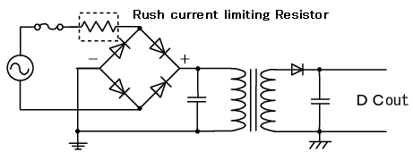

Resistors to limit the rush current
A typical power supply circuit is shown below. Rush current flows to charge the capacitor having a large value, when the power is turned on. A resistor is used to eliminate the rush current. This resistor should withstand the rush current of several ten's of Amperes and neither emit smoke nor catch fire even when the switching transistor breaks down to be subjected to a larger current. From these standpoints, wire-wound ceramic cement resistors BGR and BWR or metal-plate ceramic cement resistors BPR are recommended. Wire-wound with a built-in fuse ceramic resistors WF are also recommended to protect from continuous over-current.
