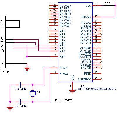

            đây là mạch nạp cho con 89s51 bạn có thể tự lắp được.nếu không muốn đi mua.lắp chạy ngay.mới học bạn bắt đầu bằng con này cũng được.tớ cũng vậy.

                Atmel 89 Series Device Programmer
                Atmel 89 Series Device Programmer :
                Powerful programmer for the Atmel 89 series of microcontrollers that includes 89C51/52/55, 89S51/52/55 and many more. With this article you can make your own programmer.
                This is a complete programming solution when it is attached to a suitable power supply and connected to your personal computer.
                FeaturesSupports major Atmel 89 series devices :
                - Auto Identify connected hardware and devices
                - Error checking and verification in-built
                - Lock of pograms in chip supported to prevent program copying
                - 20 and 40 pin ZIF socket on-board
                - Auto Erase before writing and Auto Verify after writing
                - Informative status bar and access to latest programmed file
                - Simple and Easy to use
                - Works on 57600 speed
                contents :
                - 89sch.gif : schematic
                - 89serieshex.zip : hex format firmware ( see readme.txt inside)
                - Proload41setup : setup file for PC Program
                - 89seriespcb : pcb layout
                - 89seriesbom : bill of materials
                Bui Tan Duoc (suu tam va gioi thieu !)
