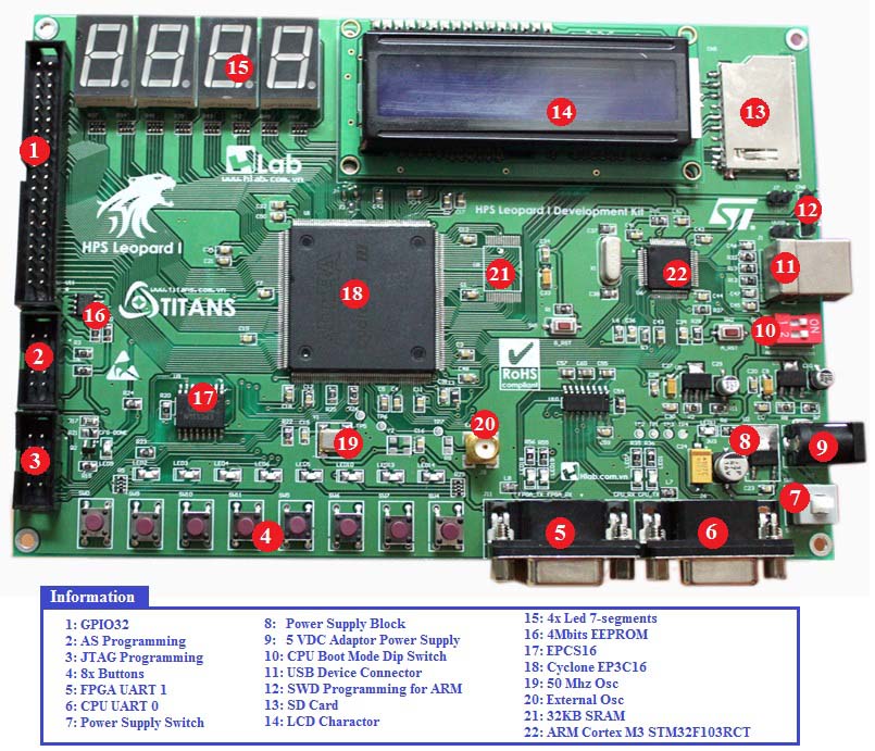

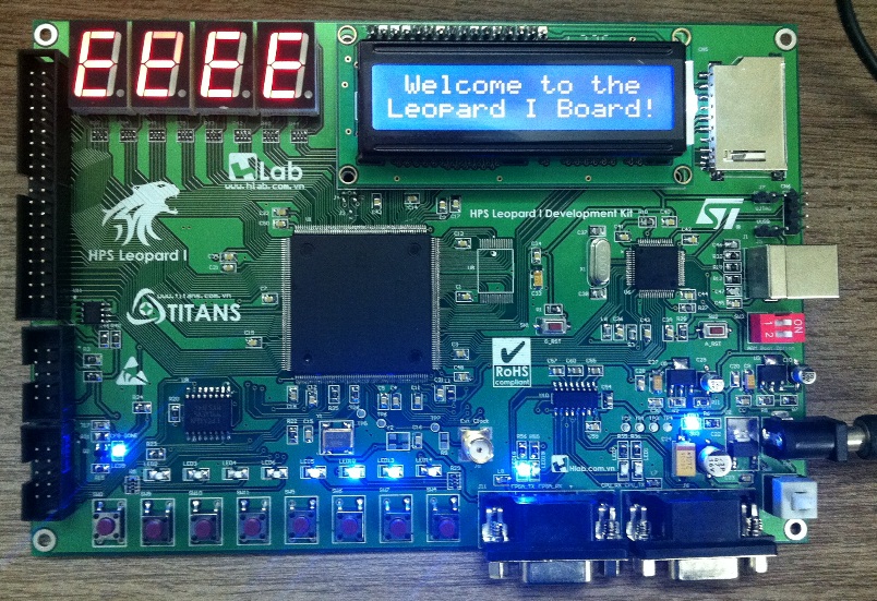

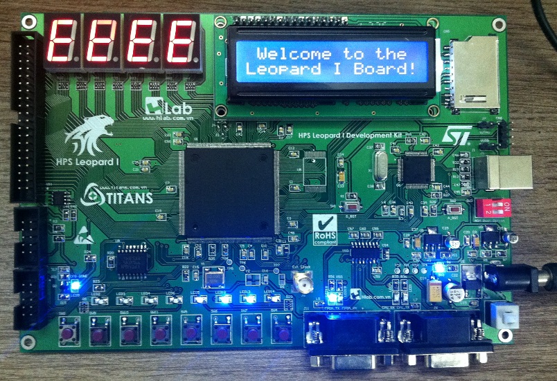

                    Kit FPGA của Titans Technology
                    Bên Titans Technology (Titans Technology) mới phát triển kit FPGA Cyclone 3 có giá phù hợp với sinh viên, các bạn có thể tham khảo ở link : FPGA Leopard I Development Kit.
                    Cyclone III EP3C16Q240
                    ARM Cortex M3 STM32F103RCT
                    8x User Buttons, 8x general purpose leds
                    USB 2.0 Interface
                    LCD 16x2 charactor.
                    4x Led 7-Segments
                    2x RS232 with DB9 Connector
                    MMC/SD Card socket
                    32KB SRAM
                    4Mbits EEPROM
                    AS and JTAG configuration support.
                    3 Oscilators : 50Mhz, 27Mhz, external SMA
                    40-Pins Expansion Connector.
                    15.400 LEs.
                    56 M9K Memory Blocks.
                    516.096 On-chip Memory bits.
                    56 18x18 Multipliers.
                    4xPLL.
                    Maximum 160 IOs.
                    STM32F103RCT
                    ARM 32-bit Cortex™-M3 CPU
                    72 MHz maximum frequency, 1.25 DMIPS/MHz (Dhrystone 2.1) performance at 0 wait state memory access
                    512 Kbytes of Flash memory
                    64 Kbytes of SRAM
                    3 × 12-bit, 1 μs A/D converters (up to 21 channels)
                    2 × 12-bit D/A converters
                    DMA: 12-channel DMA controller
                    Debug Serial wire debug (SWD) & JTAG interfaces
                    Up to 11 timers
                    Up to 2 × I2C interfaces (SMBus/PMBus)
                    Up to 5 USARTs (ISO 7816 interface, LIN, IrDA capability, modem control)
                    Up to 3 SPIs (18 Mbit/s), 2 with I2S interface multiplexed
                    USB 2.0 full speed interface
                    CRC calculation unit, 96-bit unique ID
