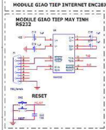

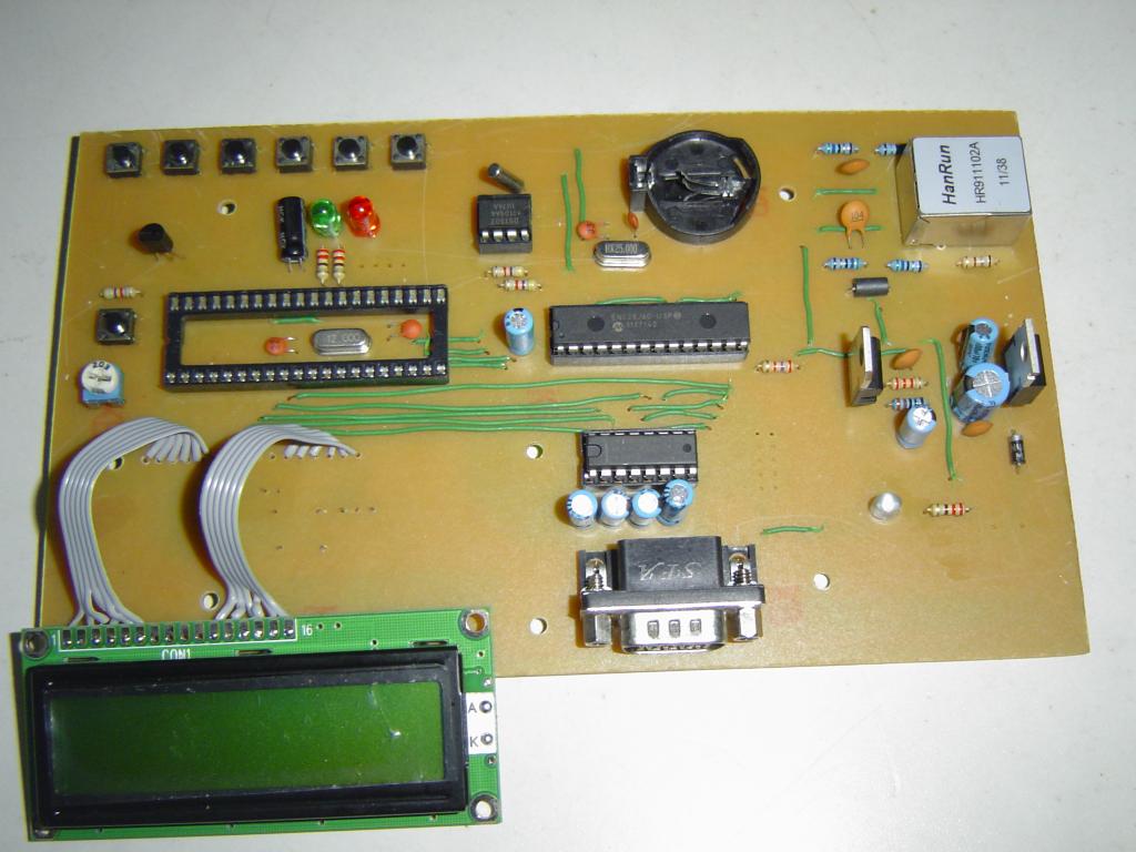

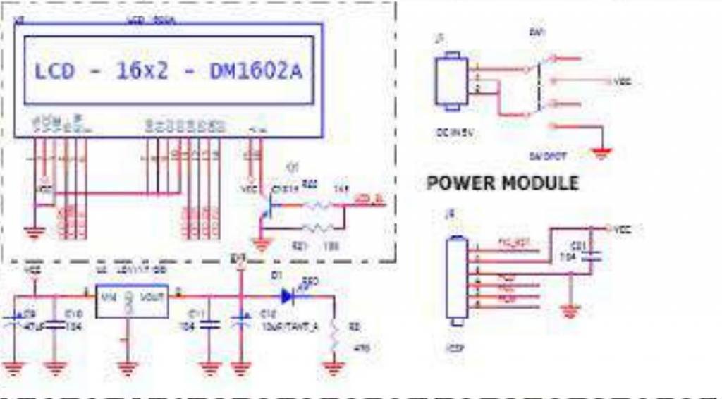

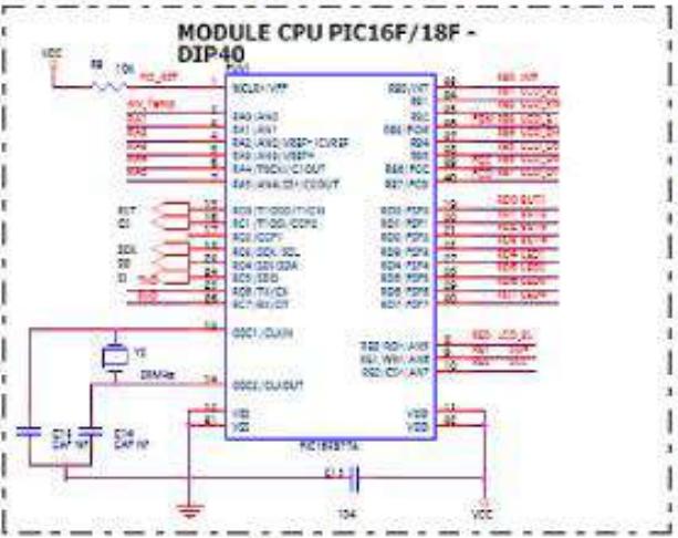

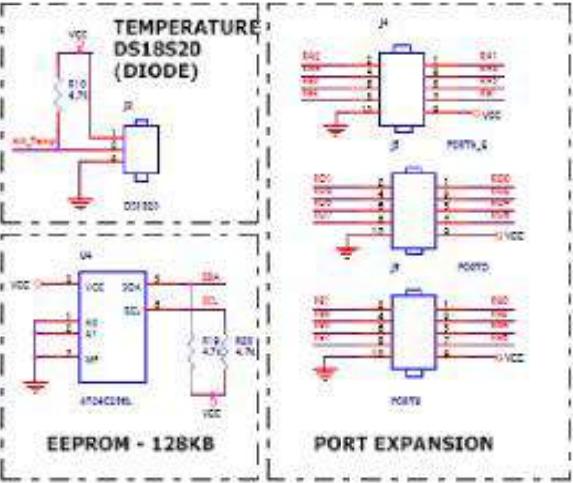

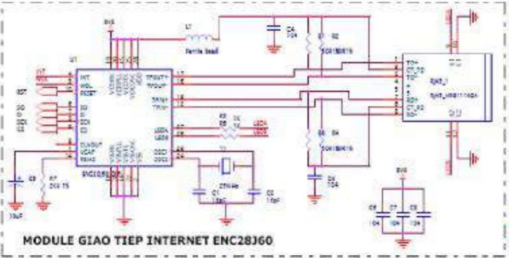

            • có chương trình này muốn đưa ra để mọi người cùng bàn luận PIC16f877a + ENC28j60 dùng CCSClick image for larger version

              #include "tcpip/stacktsk.c" //include Microchip's TCP/IP stack
              #include "ccshelper.c" //include CCS's PICDEM.net/PICNET helper
              functions
              #include "ccshelperui.c"
              /////***** WEB PAGES STORED INTO PROGRAM MEMORY *****/////
              //The following escape characters are used:
              // %0 - AN0
              // %1 - AN1
              // %2 - BUTTON0
              // %3 - BUTTON1
              // %4 - Current LCD Message
              // %5 - CHECKED if LED1 is ON
              // %6 - CHECKED if LED1 is OFF
              // %7 - CHECKED if LED2 is ON
              // %8 - CHECKED if LED2 is OFF
              // %9 - Temperature (EWL ONLY)
              // %F - Message stack
              //here is this examples / page
              const char HTML_INDEX_PAGE[]=
              "<html><body bgcolor=#FFFFFF text=#000000>
              <br/>
              <h1>CCS HTTP/CGI EXAMPLE</h1>
              <h1>leethanhnc_nhim</h1>
              <p><b><i>%F</i></b></p>
              <form method=post>
              <table border=0>
              <tr><th>LCD:</th><td colspan=4><input type=\"text\" name=\"lcd\"
              size=20 maxlength=16 value=\"%4\"></td></tr>
              <tr><th>LED1:</th><td><input type=\"radio\" name=\"led1\" value=1
              %5></td><td>ON</td>
              <td><input type=\"radio\" name=\"led1\" value=0
              %6></td><td>OFF</td></tr>
              <tr><th>LED2:</th><td><input type=\"radio\" name=\"led2\" value=1
              %7></td><td>ON</td>
              <td><input type=\"radio\" name=\"led2\" value=0
              %8></td><td>OFF</td></tr>
              </table>
              <input type=\"hidden\" name=\"msgStack\" value=\"LCD/LEDs
              changed!\">
              <br/><input type=\"submit\"></form>
              <p><a href=\"/analog\">Analog Readings</a></p>
              </body></html>";
              //<img src=\"http://www.ccsinfo.com/images/CCSlogotiny.gif\">
              const char HTML_ANALOG_PAGE[]=
              "<html><body bgcolor=#ffffff text=#000000>
              <h1>PICNET ADC READINGS</h1>
              <p>%0</p>
              <br/>%1
              <p>%2</p>
              <br/>%3
              <p>%9</p>
              <p><a href=\"/\">Change LCD/LEDs</a></p>
              </body></html>";
              /////***** END OF WEB PAGES STORED INTO PROGRAM MEMORY *****/////
              char g_HTTPMessageStack[20]="";
              char g_HTTPLCDMessage[20]="CCS Webserver";
              //this is a callback function to the HTTP stack. see http.c
              //this demo provides to web "pages", an index (/) and an about
              page (/about)
              int32 http_get_page(char *file_str)
              int32 file_loc=0;
              static char index[]="/";
              static char about[]="/analog";
              if (stricmp(file_str,index)==0)
              file_loc=label_address(HTML_INDEX_PAGE);
              else if (stricmp(file_str,about)==0)
              file_loc=label_address(HTML_ANALOG_PAGE);
              return(file_loc);
              //this isn't a required callback, this is an application function
              being
              //used by http_format_char.
              int http_format_char_checked(int8 flag, char *str)
              int len=0;
              if (flag)
              sprintf(str,"checked=\"checked\"");
              len = 7;
              return(len);
              // %0 - AN0
              // %1 - AN1
              // %2 - BUTTON0
              // %3 - BUTTON1
              int8 http_format_char(int32 file, char id, char *str, int8
              max_ret) {
              char new_str[25];
              int8 len=0;
              int8 i;
              switch(id) {
              #if defined(ADC_CHAN_0)
              case '0':
              set_adc_channel(ADC_CHAN_0);
              delay_us(100);
              i=read_adc();
              sprintf(new_str,"<B>AN%U = </B>0x%X",ADC_CHAN_0,i);
              len=strlen(new_str);
              break;
              #endif
              #if defined(ADC_CHAN_1)
              case '1':
              set_adc_channel(ADC_CHAN_1);
              delay_us(100);
              i=read_adc();
              sprintf(new_str,"<B>AN%U = </B>0x%X",ADC_CHAN_1,i);
              break;
              #endif
              #if defined(USER_BUTTON1)
              case '2':
              sprintf(new_str,"<B>BTN1 = </B>");
              if (!BUTTON_PRESSED(USER_BUTTON1))
              sprintf(&new_str[14], "UP");
              else
              sprintf(&new_str[14], "DOWN");
              break;
              #endif
              #if defined(USER_BUTTON2)
              case '3':
              sprintf(new_str,"<B>BTN2 = </B>");
              if (!BUTTON_PRESSED(USER_BUTTON2))
              else
              break;
              #endif
              case '4':
              strncpy(new_str, g_HTTPLCDMessage, sizeof(new_str));
              new_str[sizeof(new_str)-1] = 0;
              len = strlen(new_str);
              break;
              case '5':
              len = http_format_char_checked(g_LEDState[0], new_str);
              break;
              case '6':
              len = http_format_char_checked(!g_LEDState[0], new_str);
              break;
              case '7':
              len = http_format_char_checked(g_LEDState[1], new_str);
              break;
              case '8':
              len = http_format_char_checked(!g_LEDState[1], new_str);
              break;
              #if STACK_USE_TEMP
              case '9':
              sprintf(new_str, "Temp: %6.2w&ordm F", read_full_temp());
              new_str[len]=0;
              break;
              #endif
              case 'F':
              strncpy(new_str, g_HTTPMessageStack, sizeof(new_str));
              g_HTTPMessageStack[0] = 0;
              break;
              if (len){
              strncpy(str, new_str, max_ret);
              }else
              *str=0;
              return(len);
              //in this example it verifies that "pwd" is "master", if it is
              //then it sets led1 and led2 ("led1" and "led2") based on their
              value
              //and changes the lcd screen ("lcd").
              void http_exec_cgi(int32 file, char *key, char *val) {
              static char led1_key[]="led1";
              static char led2_key[]="led2";
              static char lcd_key[]="lcd";
              static char msgStack_key[]="msgStack";
              int8 v;
              // #if defined(USER_LED1)
              if (stricmp(key,led1_key)==0) {
              v=atoi(val);
              g_LEDState[0]=v;
              // #endif
              // #if defined(USER_LED2)
              if (stricmp(key,led2_key)==0) {
              v=atoi(val);
              g_LEDState[1]=v;
              // #endif
              if (stricmp(key, msgStack_key)==0)
              strncpy(g_HTTPMessageStack, val,
              sizeof(g_HTTPMessageStack));
              g_HTTPMessageStack[sizeof(g_HTTPMessageStack)-1] = 0;
              if (stricmp(key,lcd_key)==0) {
              strncpy(g_HTTPLCDMessage, val, sizeof(g_HTTPLCDMessage));
              g_HTTPLCDMessage[sizeof(g_HTTPLCDMessage)-1] = 0;
              #if STACK_USE_PICDEM_LCD
              printf(lcd_putc,"\f%s",val);
              #endif
              void splash(void) {
              #IF STACK_USE_PICDEM_LCD
              printf(lcd_putc,"\fCCS Webserver");
              #ENDIF
              #if STACK_USE_ANNOUNCE
              InitAnnounce(" - EX_ST_WEBSERVER");
              #endif
              #if STACK_USE_SERIAL
              fprintf(USER,"\r\n\r\nCCS ex_st_webserver\r\n");
              ui_settings();
              ui_menu();
              #endif
              void main(void)
              fprintf(USER,"Init...");
              init(); // ccshelpers.c
              printf(lcd_putc,"\nAll Init OK ");
              fprintf(USER,"\nInit OK");
              delay_ms(1000);
              splash();
              while (TRUE) {
              restart_wdt();
              if (kbhit(USER)) {
              ui_handle();
              #endif
              //every second: refresh current IP, blink LED
              if (second_counter>=1) {
              display_ip_lcd();
              #if defined(USER_LED3)
              output_toggle(USER_LED3);
              #endif
              second_counter=0;
              //just something to test the buttons
              #if STACK_USE_CCS_PICNET
              if (BUTTON_PRESSED(USER_BUTTON1))
              output_low(USER_LED1);
              else
              if (g_LEDState[0])
              else
              output_high(USER_LED1);
              if (BUTTON_PRESSED(USER_BUTTON2))
              output_low(USER_LED2);
              else
              if (g_LEDState[1])
              else
              output_high(USER_LED2);
              #elif STACK_USE_CCS_PICENS
              if (g_LEDState[0])
              else
              if (g_LEDState[1])
              else
              if (BUTTON_PRESSED(USER_BUTTON1)) output_low(USER_LED3);
              #endif
              #if STACK_USE_PPP
              if (ppp_is_connected()) {
              #endif
              StackTask(); //Microchip's TCP/IP stack handler.
              Must be called routinely.
              #if STACK_USE_PPP
              #endif

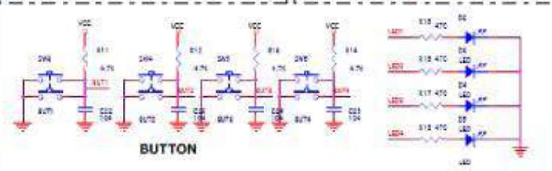

              • thêm 1 hinh nữa

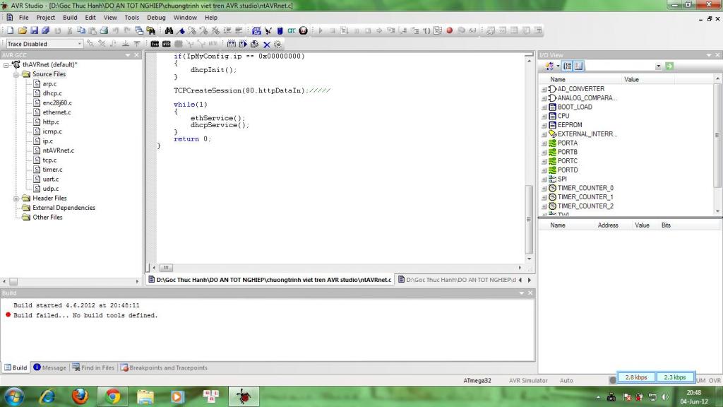

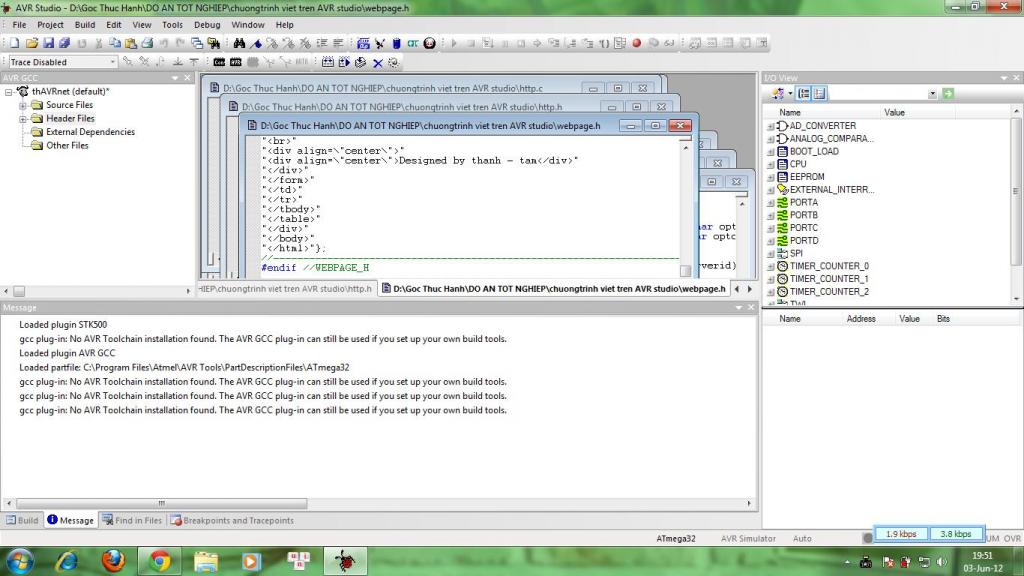

                • co ai xem dum minh chuong trinh minh sai cho nao khong. thanksClick image for larger version
                  chuongtrinh viet tren AVR studio.rar
                  Điện tử viễn thông - Hutech

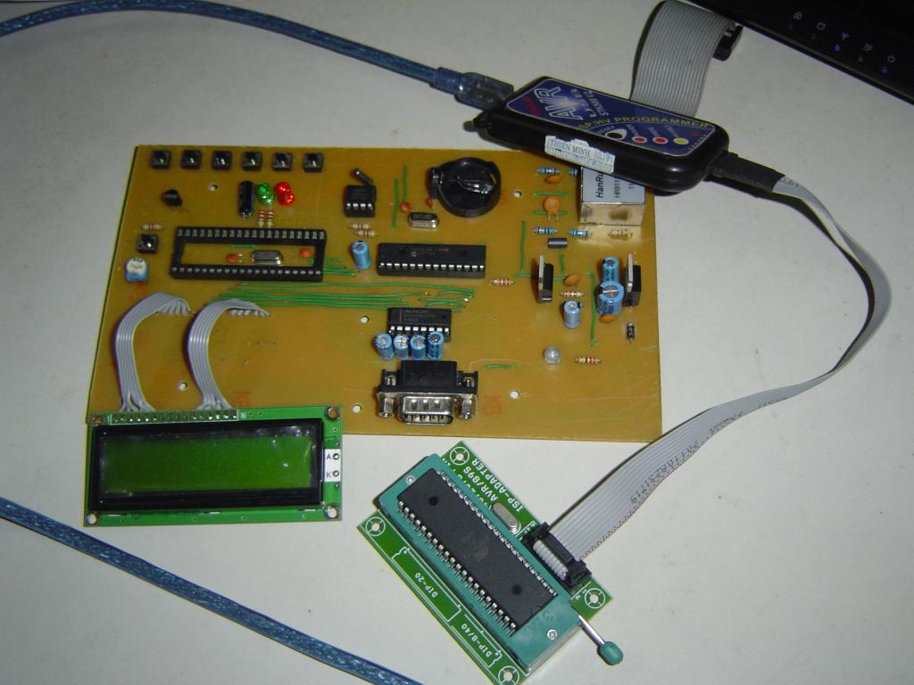

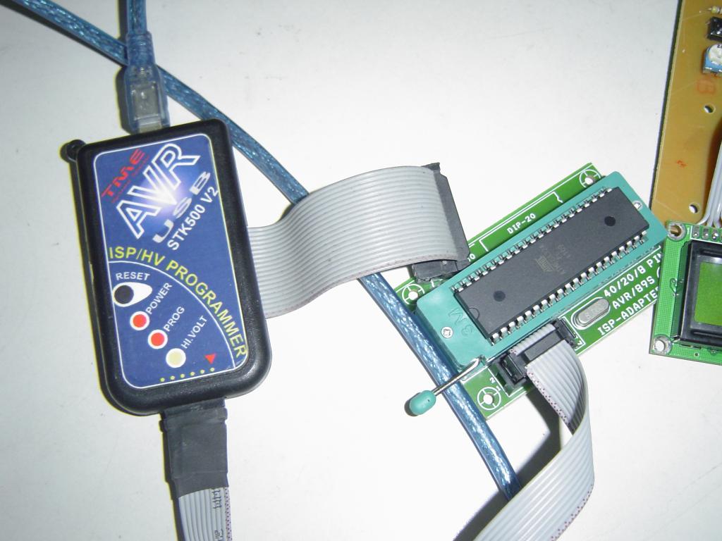

                  • mình dùng card nạp stk500 isp/hv của thiên minh mà sao ko dc, bình thường quen sài trên codevisionAVR rồi nên giờ chuyển qua AVR studio chưa quen mong mọi người giúp đỡ
                    • Hình như hồi trước em gặp lỗi này rồi! Nếu như chưa tìm ra cách sửa anh thử gỡ winavr ra cài lại xem có được ko?
                      Sao firmware của anh trong ntAVRnet.h lại có hàm main ạ? em thấy trong ntAVRnet.c cũng có. TIMER_INTERRUPT_HANDLER(SIG_OVERFLOW1) cũng bị lặp 2 lần.
                      • uhm mình thấy rồi thanks bạn nha. mà mình tháo ra cài avr studio rồi mà vẫn bị vậy ko biết tại sao nữa

                        • nhờ bạn debug chương trình mình xem dc ko sao làm hoài ko debug dc bạn ơi chán quáClick image for larger version
ID:	1362419Click image for larger version
ID:	1362420Click image for larger version
                          bị lỗi khác nữa hixhixx
                          • à có lẽ do mình chưa cài WinAVR
                            • Em build bài của anh cứ bị lỗi Build failed... No build tools defined. Em ko biết tại sao. Các project khác em build vẫn ngon nên chắc ko phải tại winavr!
