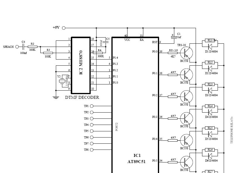

    Đoạn code điều khiển, cái mà cần phải biết để chỉnh sửa lại theo ý của mình.
    ; TP RELAYS ON PORT 0 DTMF ON PORT 1
    ; STATUS ON PORT 2
    ;$MOD51
    LED EQU P1.7
    TONE_D EQU P3.6
    TONE_B EQU P3.4
    REL1 EQU P3.0 ; LINE CHANGE-OVER RELAY
    REL2 EQU P3.1 ; RINGING RELAY
    MELODY EQU P3.7 ; UM66T MELODY GENRATOR
    ZERO EQU 10
    F10 BIT 78H ; BIT FLAG
    F11 BIT 79H
    Ph BIT 7AH
    On_Hook MACRO ; HOOK SWITCH ON P1.6
    SETB P1.6
    ENDM
    Off_Hook MACRO ; HOOK SWITCH ON P1.6
    CLR P1.6
    ENDM
    ; INTERRUPT VECTOR TABLE
    ORG 00H ; ENTRY ADDRESS FOR 89C51 RESET
    AJMP MAIN ; MAIN STARTS BEYOND INTERRUPT VECTOR SPACE
    ORG 1BH ; VECTOR ADDRESS FOR INTERRUPT
    SETB Ph ; MARK "THIS IS A PHONE CALL"
    AJMP PHONE ; JUMP TO PHONE CALL SERVICE
    ; M A I N
    ORG 02CH ; START BEYOND THE VECTOR TABLE
    MAIN:
    ACALL INITIALIZE_SUB ; INITILIZE CONTRO RAGISTER(TMOD & IE)
    START:
    CLR LED
    ACALL SCAN_TPs
    JB F10,INTERCOM
    SETB LED
    ACALL SCAN_TPs
    JB F10,INTERCOM
    AJMP START
    ; INTERCOM SERVICE
    INTERCOM:
    CLR F10 ; RESET FLAG
    Off_Hook ; DISABLE PHONE CALL
    SETB TONE_D ; ON DIAL TONE
    SETB TONE_B ; ON BUSY TONE
    CLR LED ; ON LED PERMANENTLY
    CPL A
    MOV P0,A ; CONNECT SCANED No. TO SPEACH-BUS
    ACALL GET_DIAL_NUM ; GET NUMBER TO CALL
    CJNE A,#0FFH,INTERNAL ; IF DIAL=FF THEN PHONE CALL FROM INTERCOM
    CLR REL1 ; CONNECT SPEACH-BUS TO PHONE LINE
    Off_Hook ; OFF-HOOK SYSTEM
    AJMP EXTERNAL_CALL
    INTERNAL:
    MOV R3,A ; SAVE SUBSCRIBER No. INTO R3
    ANL A,P0
    MOV P0,A ; CONNECT DIALED No. TO SPEACH-BUS
    MOV A,R3 ; PROCESSING FOR CHECKING SUBSCRIBER
    ANL A,P2 ; AND SUBCRIBER WITH CALLER
    ACALL BELL ; RING THE BELL
    EXTERNAL_CALL:
    ACALL DELAY_HS
    SPEACH: MOV A,P2
    CJNE A,#255,SPEACH ; IF CALL COMPLETE THEN RESET SYSTEM
    ACALL RST_SYSTEM ; ELSE WAIT HERE
    AJMP START
    ;THIS ROUTINE CHECKED TP'S STATUS IF ANY OFF_HOOK FOUND SERVICE
    ;PROVIDED HIM
    SCAN_TPs: ; FLASHING LED WITH SCANING TPs
    MOV R0,#76
    LOOP: MOV R1,#250
    _1: MOV A,#1 ; START POINTER WITH ONE
    JB P2.0,_2
    SETB F10
    AJMP OUT
    _2: RL A
    JB P2.1,_3
    SETB F10
    AJMP OUT
    _3: RL A
    JB P2.2,_4
    SETB F10
    AJMP OUT
    _4: RL A
    JB P2.3,_5
    SETB F10
    AJMP OUT
    _5: RL A
    JB P2.4,_6
    SETB F10
    AJMP OUT
    _6: RL A
    JB P2.5,_7
    SETB F10
    AJMP OUT
    _7: RL A
    JB P2.6,_8
    SETB F10
    AJMP OUT
    _8: RL A
    JB P2.7,BACK
    SETB F10
    AJMP OUT
    BACK: DJNZ R1,_1
    DJNZ R0,LOOP
    OUT: RET ; RETURN FROM SUB ROUTINE
    ; THIS ROUTINE RINGING THE BELL ON DIALED NUMBER
    BELL:
    CLR TONE_D ; OFF DIAL TONE
    CLR REL2 ; ON BELL RELAY
    ACALL DELAY ; RING BELL FOR ONE MINIT
    SETB REL2 ; OFF BELL RELAY
    ACALL DELAY
    JB F10,RET1
    ACALL DELAY1
    JB F10,RET1
    ACALL DELAY1
    JB F10,RET1
    AJMP BELL
    RET1: RET
    ; CHECK TELEPHONE'S STATUS UPTO ONE SECOND
    ; IF PIKED UP THEN SET FLAG
    DELAY1: ; ONE SECOND DELAY WITH STATUS CHECKING
    MOV R0,#4
    LOOP11: MOV R1,#250
    LOOP12: MOV R2,#250
    LOOP13: CJNE A,P2,NOT_EQ
    SETB F10 ; MARK SUBSCRIBER READY TO TALK
    AJMP RET2
    NOT_EQ: DJNZ R2,LOOP13
    DJNZ R1,LOOP12
    DJNZ R0,LOOP11
    RET2: RET
    ; ONE SECOND DELAY
    DELAY: ; ONE SECOND DELAY
    MOV R0,#4
    LOOP1: MOV R1,#250
    LOOP2: MOV R2,#250
    LOOP3: NOP
    NOP
    DJNZ R2,LOOP3
    DJNZ R1,LOOP2
    DJNZ R0,LOOP1
    RET
    ; READ DIALED NUMBER,RE-CHECK IF 0, * OR #
    GET_DIAL_NUM:
    JNB P1.4,$ ; WAIT FOR KEY PRESS (STROB)
    MOV A,P1 ; READ DIALED NUMBER
    ANL A,#00001111B ; REMOVE EXTRA BITS
    CJNE A,#ZERO,STERIK ;
    JB Ph,GET_DIAL_NUM ; IF ZERO FROM PHONE CALL THEN READ AGAIN
    MOV A,#0FFH ; TRUNK CALL FROM INTERCOM
    AJMP RET3
    STERIK: CJNE A,#11,HASH ; IF STERIK, READ AGAIN
    AJMP GET_DIAL_NUM
    HASH: CJNE A,#12,NINE ; IF HASH, READ AGAIN
    AJMP GET_DIAL_NUM
    NINE: CJNE A,#9,DECODE
    JNB Ph,GET_DIAL_NUM ; DIAL=9 & NOT A PHONE THEN READ AGAIN
    MOV A,#252 ; SELECT TO ALL (VIRTUALY 8)
    AJMP RET3
    DECODE: DEC A
    MOV R1,A
    MOV A,#1
    ROTATE: RL A
    DJNZ R1,ROTATE
    CPL A
    RET3: RET
    ; RESET ALL SYSTEM
    RST_SYSTEM:
    CLR TONE_D ; OFF DIAL-TONE
    CLR TONE_B ; OFF BUSY-TONE
    CLR Ph ; CLEAR PHONE CALL FLAG
    CLR F11
    MOV P0,#255 ; OFF ALL TPs RELAYS
    SETB REL1 ; OFF CHANGE-OVER RELAY
    SETB TR1 ; START TIMER/COUNTER
    On_Hook ; ENABLE PHONE CALL
    RET
    ; INITIALIZE SYSTEM
    INITIALIZE_SUB: ; SET UP CONTROL REGISTERS
    MOV TMOD, #01100000B ; TIMER 1 IS SET FOR MODE 2, COUNTER OPERATION
    MOV IE, #10001000B ; ENABLE TIMER/COUNTER 1 INTERRUPT
    MOV TH1, #219 ; AUTO RELOAD VALUE(INT1 TL1) EACH TIME AFTER OVERFLOW.
    MOV TL1, #219 ; DEMO TIMER IS INITIALISED WITH (256-39=217)
    ; TO COUNT 39(2BELL)EVENTS
    SETB TR1 ; START COUNTER 1
    RET
    ; PHONE CALL SERVICE
    PHONE:
    CLR TR1 ; STOP TIMER1
    ACALL UM66 ; PLAY MELODY
    NEXT: ACALL GET_DIAL_NUM ; GET NUMBER TO CALL
    SETB REL1 ; DISCONNECT FOR BELL
    ACALL DELAY_HS ; PROVIDE HALF SECOND DELAY
    BUSY: MOV A,P2
    CJNE A,#255,BUSY ; IF CALL NOT COMPLETE, WAIT ARROUND HERE
    JB F11,RESET ; CHECK FOR SECOND CALL
    MOV P0,#255 ; DISCONNECT ALL TELEPHONES
    SETB F11 ; MARK FOR SECOND PHONE CALL
    AJMP NEXT ; GO FOR NEXT PHONE CALL
    RESET: ACALL RST_SYSTEM ; END CALL
    RETI
    ; PLAY MELODY (UM66)
    UM66: CLR MELODY ; PLAY MELODY AS GREETING MESSAGE
    ACALL DELAY ; FOR FIVE SECOND
    ACALL DELAY
    ACALL DELAY
    ACALL DELAY
    ACALL DELAY
    SETB MELODY ; STOP MELODY
    RET
    ; HALF SECOND DELAY TO ESTABLISHED THE RELAY CONTECTS
    DELAY_HS: ; HALF SECOND DELAY
    MOV R0,#2
    LOOP21: MOV R1,#250
    LOOP22: MOV R2,#250
    LOOP23: NOP
    NOP
    DJNZ R2,LOOP23
    DJNZ R1,LOOP22
    DJNZ R0,LOOP21
    RET
    END
